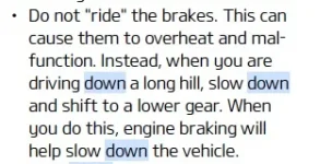

Page 5-17:
As I mentioned above, when I come down the hill near my home, I set cruise control to the speed limit and the engine brakes automatically by downshifting as needed.
