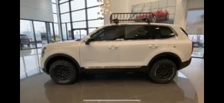

Sorry, that’s all I had. I am modifying one currently for rough terrain but not much sand..

That looks sweet man! Can you share the details on what you did? What lift kit? Wheels and tires? I just picked up my EX gravity grey yesterday and wanted to do something similar... I found this pic online of what I want to do.. this one is a LX with a 2” lift kit.. the only one I’ve found is made by Truxx (2020 Kia Telluride & Hyundai Palisade - 2.0" Lift Kit #306015 | Truxxx.com)..

Let me reach out to my Upfitter to get you those details. New England Vehicle Outfitters in NH is doing all my work on it, I’ll let you know

The lift is a Truxx 2” kit. The wheels are 18x8 with a 38mm offset. The tires are a Toyo Open Country AT3 in a 265/60/18.

Thanks for looking into that for me.. I’ve found a few posts about that Truxx kit and everyone seems to be pretty happy with it.. doesn’t impact the ride negatively at all... and fairly inexpensive.. appreciate it!

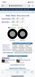

From my shop FYI,
“We got the lift installed Friday and they guys had some rubbing issues and realized that the tires were actually the wrong size. They delivered them to us with a 265/65 not a 265/60. There is about a 1.1” difference in those 2 sizes”

Thanks! I was thinking of going the 265/65 on 17” wheels but looks like that would put me in the same place..
