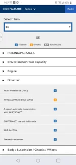

The parts fiche for the Telluride is not available yet. So I looked up the parts fiche for the 2019 Sorrento and it shows a transmission oil cooler for both the V6 and 4 cyclinder engines.
However I have looked all over and under my SX and cannot locate a separate tranny cooler.
hammick
91
34
Looking closer at my SX there are two lines coming from what I believe is the transmission. One line goes to the top of the radiator and the other to the bottom of the radiator. Not sure the attached pic shows it very well. So it looks like the Telluride transmission does not have a separate transmission cooler. Whether it's any different than the Palisade "heavy duty" transmission cooler remains a mystery.

We need to get the member here that has both a Telluride and a Palisade to take a look and see of the Palisade has the same setup. According to the marketing literature all Palisade come standard with a heavy duty tranny cooler. Can't imagine why the Telluride would be any different.
I'll send him a PM and see if he is willing to take a look.
