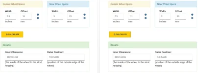

Now let’s have a look at the offset calculator.
If we go with a 20x9 wheels, the offsets would need to be 20x9 +35 front and 20x9 +30 rear for a rim-to-fender flush setup.
