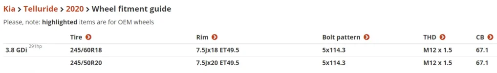

Here are the specs for the stock wheels... need to be sure there is no caliper interference and the tire will work with the rim width
7.5" wide by 18" dia with a 49.5mm positive offset
bolt pattern 5 lugs on a circle diameter of 114.3mm
Thread size is 12mm x 1.5mm
Center bore is 67.1mm
