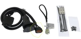

2. It appears that the 2022 wiring harness will most definitely NOT fit the 2023, at least not on the SX-P X-Pro. Here are some pictures comparing the 2022 harness to my 2023 connectors. The 2020-2022 Tellurides had a dedicated connector to plug in the towing harness, whereas the 2023 does NOT have the same connector. In fact, it looks like the towing harness for 2023 will need a pass-through style design.
Picture from e-trailer video showing where to plug in the 2022 style harness (note two connectors):
2020-2022 Wiring Harness Picture (note the style of the female harness circled):
Picture from my 2023 SX-P X-Pro harness location (note there is only 1 connector now):
Pictures of the mating sides of the 2023 connector:
(Side leading towards the rear taillights, etc.):
(Side leading to the front of car):

I found that FAQ and at least now we know the location of this harness plug, however, looking at the recommended harness p-118784 dot html, it does not appear to fit based on these pics I took. Also, I need the 7 pin as opposed to the 4 pin. Slowly, but surely, we are getting closer.
The pins appear to be different between what I have on my 2023 KIA Telluride and the image from the actual product on eTrailer.
