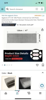

I purchased ABS plastic grill mesh from Amazon to use on my 2023 EX. It is pretty stiff and about 1/8 inch thick. I originally wanted to place the mesh on the inside of the openings so I started a return and ordered wire mesh. After studying the grill openings, I decided it would be easier to install the plastic mesh on the outside.
The cross bars on the lower 2 openings are recessed slightly from the bumper surface. I cut the mesh to fit the recessed area and zipped tied to the horizontal bar.
The middle opening is set back from the bumper surface at the top and bottom but not the sides. I found 2 cable clips in my junk drawer and was able to clip them over the back edge of the grill opening on the outer side edges. The clips had a screw hole and I was able thread a zip tie through the hole to secure the outer most edge of the mesh
Overall I’m pretty happy with the result. I haven’t decided how to address the open area at the top. Any mesh used for the top definitely needs to go behind the grill. I’m not ready to attempt removing the entire bumper. The plastic gutter guard mesh may be the answer
Pictures below.

Looks good. I like it.

I bought the same mesh for my 2023 and plan to put it on this weekend. The install would look much cleaner if the grill was behind the bumper, the upper one looks a bit out of place. You should consider taking the bumper off, its really not difficult. If you can turn a screwdriver and a wrench, you can take off a bumper. Its just a few bolts and push pins, a lot less complicated than you think.
