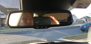

I've looked in my manual but the programming buttons on my Telly are not like the one in the manual, which I am assuming is for the SX model. Mine has only one power button which I guess is for turning on/off the auto-dim feature, a light that goes green on the left when on, and a light that doesn't seem to do anything on the right (see photo).
So, is there a way to program my garage door opener to this mirror? This feature had been around 15+ years so it seems off if the answer is no.
Also, what is the light on the right side of the mirror for?

The EX does not have Homelink, so it can't be programmed for garage door. You could add an aftermarket solution if desired - probably less than $400 installed. Right side is a light sensor for activating auto dim function.
