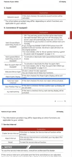

If you have the “rear wipers on in reverse gear” in the driver assist settings in the instrument cluster, this might be the explanation if you were backing up. Usually it is only a single wipe when active, even if rear wipers are in off position.
Maybe a glitch from that feature if you had that setting enabled while in drive.
Hmm - I tried to find such a setting and could not find it.
User Settings > Convenience
Not Driver Assist as I previously mentioned.
Ah yes, there it is. I’m 99% sure that’s what was going on. A feature I didn’t know I had. Thanks.
