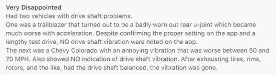

Very interesting app. Of course, I did read one review (screenshot below) on what turned out to be a drive shaft problem that was not identified by the app. I wouldn't necessarily expect the app to be perfect, but that is a lot of money to shell out for something that may not help solve the problem in the end. It seems like the price point is specifically geared to those who either reached their wits end trying to solve a vibration problem or someone who would generate income from using it. I wouldn't consider this until I exhausted my dealer and third party professional options. In the end, for most of us, this would only be a data point that would hopefully lead to convincing someone else that there is an actual problem.
