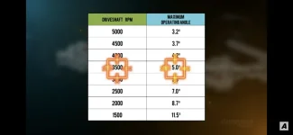

Learning so much about driveshafts following this thread. This video great for those trying to keep up with the discussions.
Max working angle and velocity fluctuations really are explained very well in terms of how it can cause vibrations.
At 4:50, phasing (synchronizing u joints) is explained. Another potential cause of heavy vibration if sync not installed properly.
