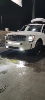

It’s honestly much brighter than I expected lol.
Is there enough room for a duel row led light bar to fit or only a single row because if a duel row will fit a RGB one would be awesome.
Is it hard to clean it off when it becomes dirty, I do like this idea a lot?
I do like the functionality that these LED light bars provide on my truck it wasn't a big issue to hide them as it is on the Telluride .
The mounting position on my truck any wind noise is too far back on the cab and she's well insulated.😁
On a side note I gotta say I do love driving down back roads with these on LOL😎

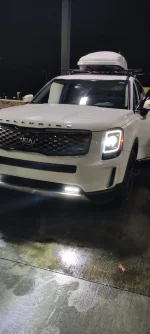

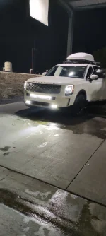

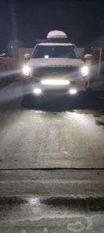

LED fog and LED light bar done. I do apologize now but I completely spaced on taking pictures along the way. Everything said and done about 4hrs wiring and mounting. If anybody has any question please ask and I will try to explain on what I did to mount and wire.
Looks great! Nice job.

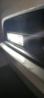

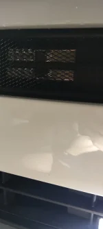

I also received that same message. Couldn’t wait so I ended up buying everything separately. OEM Fog lights, new bottom plastic cover whatever it’s called that has the openings for the Fog lights and the switch to wire them to the battery. Looks 100% OEM 🥳👍 , The only thing that isn’t OEM is the switch. Too much of a hassle to figure it all out and too much money to get it to work. OEM bottom cover was around $110, and I was able to find each OEM Fog lights with some broken tabs which I repaired myself for around $70 each and $9 switch from Amazon. Couldn’t be happier. Here are some pictures. Took my time and since I had the front bumper I decided to install the mesh screen to protect the radiator. Spend less than $20 on the supplies screen roll and some black zip ties. 😁😎88D9A559-768B-4F86-A644-B66ADD174E44.webp6E1E0372-7251-4569-ABE8-FB3768DDB7E7.webp2C595265-D316-4291-B4F8-6902BF5DB97B.webpCADE6766-2D2C-421D-9F75-0EF45D4352DD.webp19E3627F-B3B5-4410-A88C-1E4122A0AC62.webpD7FF395E-B90F-4194-B59F-3EF0B9F95AA5.webp4DAB4CBC-4A52-4BE2-B8BE-F6FB3301C813.webp51A3727A-A09D-494D-859D-345ACF3E73FC.webp9DD35894-89B0-4875-9D97-FC953142E619.webp
