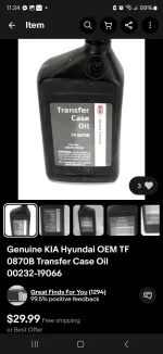

Change your fluid in your coupler it takes kia transfer case fluid 20240616_214714.webp20240616_220048.webp20240616_214714.webp20240616_220048.webp20240616_215443.webp

The coupler (different nomenclature from my older BMW world) can/is often the cause for a mystery bang or slight thump feel on acceleration. Professionally I've even been duped into thinking it was an intermittent misfire. Causing us to change coils/plugs to no avail.
Having learned a thing or two (my professional shop owners group helped) we learned to ignore the "lifetime" labels and would proactively change coupler and differential fluids at the 100,000 KM (~60,000 mile) intervals. There's just NO way a liter (or even less) of a working fluid is going to not break down and stay 100% functional over that many miles/years.
If you never went to the dentist for periodic cleaning, what would your teeth look like? Preventive maintenance goes a long way.
IMHO
