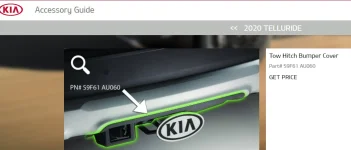

Thanks! I guess whoever is selling their original cover on Ebay is using the box for the Kia hitch cover, hence my confusion with the P/N. I suspect you can't get that original cover as a separate part. And I checked some images and videos, and sure enough the black Nightfall/Nightsky have a black cover (makes sense). I think I may pick one up on Ebay and just spray paint it black. Then reinstall the original one when I return my lease without the hitch.You can buy the replacement part you cut out all day on sites like Ebay. In fact, thats where I sold mine. Aftermarket hitches won't work with the Kia plate. I think most lease returns won't care but you don't know. You might want to just go with the KIA hitch and turn it back with it on if you aren't planning on reselling. It's not that much more for saving you the labor and time. Or just go without the cover and keep it for replacing after removing the hitch. It's all black there so not much to see.
That sounds great!Thanks! I guess whoever is selling their original cover on Ebay is using the box for the Kia hitch cover, hence my confusion with the P/N. I suspect you can't get that original cover as a separate part. And I checked some images and videos, and sure enough the black Nightfall/Nightsky have a black cover (makes sense). I think I may pick one up on Ebay and just spray paint it black. Then reinstall the original one when I return my lease without the hitch.

If you have a 2021 that did not come with the tow option (nor the tow package), I think this is what you need to add the tow option yourself with a wireless brake controller:
If you go with all the optional stuff above, I believe you have a superior towing solution to the towing package from Kia with the OEM look. At a minimum, the parts for the 2021 tow option can be had for $490 and DIY installation is not impossible.
- S9F67AC500 - 7-pin harness for 2021 only (~$150)
- S9F61AU000 - Hitch Receiver (2020 or 2021 for ~$290)
- S9F61AU060 - Bumper cover for Telluride (2020 or 2021 for ~$50)
