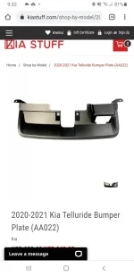

For clarification, is the bumper cover the flat black bumper plate ($45) ?
Thanks!
That piece (S9F61-AU060) is only required if you go with the Kia hitch receiver that sits embedded in the bumper. It's not needed if you go with the Curt aftermarket options (ex. Curt, Reese, Drawtite, Stealth, etc.) that all sit below the entire bumper. That black bumper plate is not shiny like the Nightfall. It matches the black molding on all other Tellurides.
To install the bumper plate you must remove two other parts (that are effectively a filler insert into the entire bumper cover.) It's incorrectly named a "hitch cover" except you use it when you don't have a hitch. So it's not removable to cover the hitch receiver. That insert has one piece that is silver on most Tellurides (86672-S9010) and a second plastic black piece called a skid plate (86673-S9000), but again it's not a skid plate, it's more like a trim finishing. Presumably the Nightfall has one or both pieces in shiny black? Some people who install the aftermarket options end up having to cut one or both of these pieces to make the aftermarket hitch fit, but you don't need the S9F61-AU060 if you are going with aftermarket.
I don't know that I have seen any Kia parts websites that sell 86673-S9000 or 86672-S9010 separately. What I have seen is the parts for the entire bumper cover that may include these parts for $350-375. I have no idea how expensive the shiny Nightfall bumper cover is to replace, but I would be scared to scratch it. Gone are the days of a bumper being the only thing you don't care about on the car. Calling a finishing piece a skid plate doesn't make sense to me. I think of a skid plate as a metal or hard plastic piece you don't really care about meant to protect the body parts. On the front of the vehicle Kia has a metal skid plat accessory that goes under the bumper. But on the rear they call the plastic molding pieces skid plates.

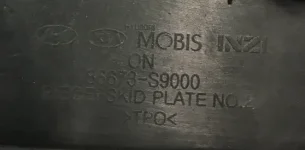

Hi 2020Telly, thanks for your explanation. I'm just still a bit confused about the difference between 86672-S9010 and 86673-S9000. Is it that the first one is silver and the latter one in shiny black (for the Nightfall black glossy bumber)? I did find an online seller offering a 86673-S9000 but it's silver though... and this filler insert or whatever we should call it doesn't show in any of the Kia parts diagram I saw. As per your comment, I think you can only get it if you order the whole bumper cover. At this point, I'm thinking perhaps getting the grey and painting it black (maybe spray paint it gloss or semi-gloss black, whatever looks the closest to the rest of the bumper). Afterall, it'll just be handed over to the dealership together with the plastic rocker panel covers that they will remove when installing my OEM sidesteps. Or maybe the other way around. I'll cut the silver one, paint it black and use it with my aftermarket hitch, leaving the black one intact....
The pictures in the post above are for the two parts that make up the silver one.
I’m assuming most people/places will sell them together. I do not know what the part numbers are for the nightfall bumper. If you go with the aftermarket hitch on the nightfall and require cutting but don’t want to cut the original, I think that buying a silver and painting it black makes sense to me.
Ahhh, I think I finally got it! The photo attached (originally posted by nightfallsx in the "2021 Telluride Nightfall Rear Bumper Skid Plate Part Number" thread) shows that second part you were referring to, right? I agree the sensible thing to do would be to get just a silver cover, cut it, paint it and attach it with my Curt aftermarket hitch. Unless a black one shows up for grabs! :) Thanks!
