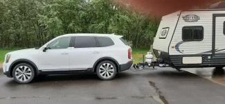

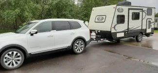

Thanks for the reminder! Sorry for long post. I have now done a couple trips. One was 90 min and the other about an hour. Both trips have been good, no issues. I would say it definitely tows better than the 2016 Sorento EX we used to tow same trailer. I like to switch to manual on hills to gear down as the cruise control isn't great on hills.
No issues with swaying or bouncing up and down after going over bumps. The lane assist (keeping vehicle in the lane) helps a lot and makes it easy to tow, especially if there is cross wind. Makes it easier on the arms.
I even towed with about half a tank of water for one trip so that increased the weight. Btw, it's a 17 foot trailer with slide out.
The dealer installed the hitch, 7 way plug and brake controller before we took delivery of the vehicle (and included as part of the purchase) so I assume it's factory hitch.
I took some photos when I stopped for gas, had to take them quickly. Not sure if it has self leveling shocks or not, but there isn't much back end sag. I also have a weight distribution hitch. I will post a pic of the installed hitch when I get home. Hope this helps, let me know if anyone has any questions.
TL;DR the Telly tows great!
