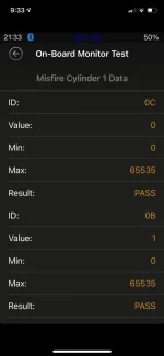

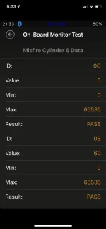

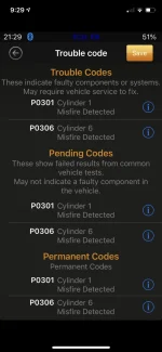

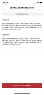

Moved my telluride (s model w/ 34k) and noticed a small spot of oil, turned it off, checked the oil and started it back up — check engine light it on. Went digging around my house and found a iOBD2 and ran diagnostics and saw that I was getting P030600 and p030100 ( apparently cylinders 1 and 6 are misfiring )

So did you schedule the appointment with your dealer as your screen advised you to? No issues here.

Sure did, closed till Monday. Everything has been running fine up until last night (except the ac smells like vinegar when it starts up)

I don’t have an endoscope. But I this is the report for both cylinders.
