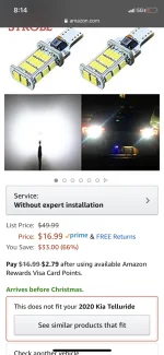

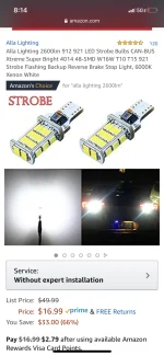

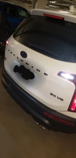

So here's my rendition of replacing the Reverse Lights With a Very Cool Looking Strobe LED Light... This is BEYOND simple to do anyone can do it so rest assure. So to answer right off the bat no these do not strobe continuously when on; when you change your gear to Reverse they strobe (blink) 3 times and then stay on for the duration the gear is in Reverse. If you have any questions feel free to reply Hope this helps!
View attachment 2860 View attachment 2861 View attachment 2862 View attachment 2863 View attachment 2864 View attachment 2865
Any idea why amazon says this part doesn’t fit?
9 out 10 Places where you go to find anything for the Kia Telluride it will say "Not compatible" or "This item does not fit" because the Telluride is a brand new model... most places haven't tested or cross referenced parts that are compatible. Clearly it is compatible if not I wouldn't have posted these lights here... (& I don't mean to sound rude... but really why would I put an incompatible part here...)
I wasn’t doubting whether it was compatible, obviously it worked if you used it successfully. I was asking why Amazon says it’s not (which you answered now). I don’t mean to sound rude, but read what I asked again, I didn’t question that you posted something not compatible. Don’t get so defensive.
