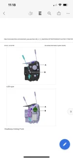

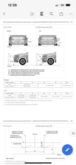

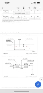

Here’s the manufacturers recommendations
Is this from work shop manual? Repair manual
I have been searching for the Repair manual of the manufacturer
There is a snapon website that allows you to selectively download the shop manuals. It cost $19 for three day access. It’s where I got the wiring diagrams from for the harnesses I made.
Letter A is the horizontal adjustment
