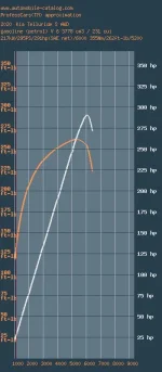

This car comes close to 3 tons. Horsepower higher than torque. To me not the best ratio. Torque down low is what you want. Has anyone seen the torque curve? Can they post it? For a number of reasons we went from a Ford F250 diesel to our telly. Modern cars are more tuned for mpg than anything else. I have a car built in 1952 that has an engine it designed for 120 horsepower and over 200 ft pounds of torque. Long stroke engine. Today's engines are short stroke designed fir higher revs. We have to learn to live with it or step back in time vehicle wise.
Found this.
Source:
