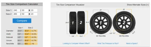

Sweet ride there. Planning to do similar with a 2" Truxxx lift + shock extension on my OEM Nightfall wheels. Trying to decide between the Wildpeak 255 and 245. Any noticeable rub with the 255 in your setup? Still happy with the ride?
At this point I don't want to add a lift kit, but I would like a bigger tire or at least taller sidewall. I have 20" wheels. What tire can I put on without rubbing?
You might be able to figure this out using two websites, discounttire.com and tiresize.com
I think if you go with 265/50R20 you will get almost an inch taller.

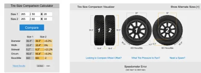

I just bought 265/60r18 motomaster all terrain tires ans fast 18x9 wheels.
I wasnt planning on putting a lift on. Do you think i can get away with it. Or will i need the 2" lift?
I'm having them balanced on the fast mags Friday. I really hope they fit... they look pretty frigging big. I'm nervous lol

It will be really close. 265/50r20 is the biggest that discount tire recommends and they're nearly the same size. If it fits please let us know! I'm really thinking about that size if it does.
Putting the 265/50/20 on today with no lift- they said it should fit just fine.
