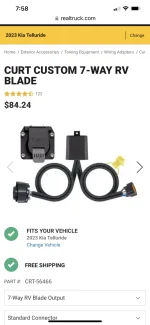

Just like others, I am very frustrated with the delays and getting no help from my dealer. Unlike others, I have zero knowledge when it comes to vehicle wiring. I will be pulling a trailer so need a 7 pin. Found one on Real Truck.
Will this work? Will it void my warranty?

NO. That product will only fit the 20-22 Telle's. It will NOT fit the 23's. Refer to the manufacturer's data:
