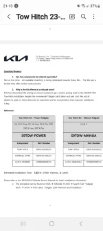

If you look at the letter from KIA HQ, they estimate the time at 1.84 hours.Screenshot_20230920_211348_Samsung Notes.webp
Assuming that the letter is legit, your labor cost seems very high.
