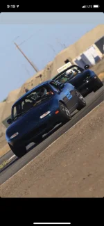

I have a 2021 SX-p with the towing package (self leveling shocks). I’ve towed my Miata to the track multiple times with a U-Haul trailer. The U-Haul trailer weighs about 2200lbs and my Miata weighs about 2400 lbs. It’s close to the limit of towing capacity but the Telly does just fine. I’m actually going to buttonwillow this weekend again.
I’m towing my brothers Miata in this pic. My Miata is the montego blue(now turbocharged) and his is the black one(supercharged).
