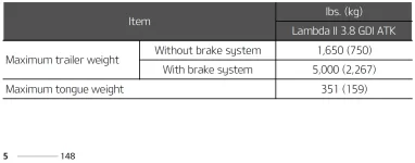

I really wish Kia would come out with a factory fix for the 7 pin wiring harness. Then the vehicle would be “perfect”... that is the only issue I am having. I look at all the 3 row vehicles on the road. Don’t understand way they only went with the 4 pin.I called KIA a while back and was told the same thing... I had, PREVIOUSLY Called KIA in Washington DC as well as wrote to their HQ in Irvine, CA. Since then, on the phone, I have been assured the 351# tongue weight IS a mistake... 500# sticker to cover the number in our manuals is coming... LOL I also told them that since so many of us wanted TOWING and they put the LAME 4 pin connector on the vehicle...I thought those who ordered it should have a 7 pin (brake connector) installed at NO ADDITIONAL COST!!! Met with silence LOL but nothing ventured, nothing gained... I was also told that the Dealers should be able to install the 7 pin system to alleviate any issues with Warranties...although aftermarket installations should have their own warranties should any other failure be attributed to them and not KIA. I would NOT have bitched but...in my state you need to have a Brake Connector if you tow more than 1650#. Just saying to them...give us something we can actually use than to have a place to intall a Bicycle or Little Rascal to our rears.![]()
TBH I wouldn't worry that much about the hitch / tongue weight. I'm not sure why people on the board are so obsessed by that.
Because if you tow a trailer while exceeding the manufacturers rating, you are creating a legal liability for yourself.
I have always seen tongue weight recommendations of “10-15%”, so it’s surprising that they say tongue weight should be a maximum of 10%. At less than 10% tongue weight, trailer sway becomes a real possibility.
I almost think it’s a mistake. Maybe they meant 351kg, which would correspond to ~15% tongue weight at 5000 lb trailer weight. Wishful thinking, probably.

If you remove the 4 pin connector the metal holder/tab on the Telluride has the cutout for the round 7 pin connector. So the connector/plug is made for the round plug.I just saw the recent posts saying the 351 lb tongue weight is a typo. That’s good news.

I'm happy with the updated 500lb pin weight, but concerned with the bulletin that says 1650 tow without brakes, 5000 with brakes.

So what brand of brake controller did you add?Kia motors incorrectly had tongue weight in manual at 350 lbs. The correct tongue weight capacity is 500 lbs. maximum trailer weight w/o brakes system is 1650 lbs. with brakes system 5000lbs. See attached
