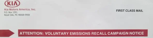

Ha. Now that you mention it I did notice it but forgot after reading the letter inside. Maybe they had a bunch of old envelopes sitting around.
exces6
12
6
Did anyone else notice the red ribbon title on the outside of the envelope:
Emissions Recall?????
Really glad you mentioned this. I got my Informed Delivery scan that this was on the way but it never arrived, and Kia didn't know what I was talking about when I called asking about an emissions recall. Thanks!
