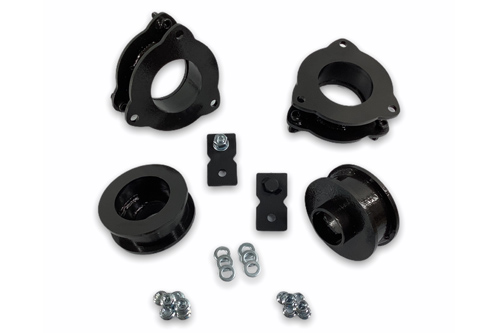

In my curiosity of looking for a spring lift, I did find these guys.
Kia Telluride Hyundai Palisade 2" Lift Kit 2019-2022 This is a straightforward install, no cutting or welding or permanent modifications needed. This 2" lift kit allows you to fit much more aggressive tires and wheels allowing your SUV to take the family and all your toys to where they need to...
4x4.fatbobsgarage.com
Maybe worth contacting since the image looks like they have shock extensions.
