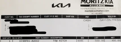

Karen, the "Expert Reply" you posted is not totally correct. There are multiple hitches available for the 2023 Telluride. Any hitch that fits the 2022 Telluride should bolt up to the 2023 Telluride. I have Kia's trailer hitch on my 2023 4WD (post 176 pg 9). I included my Kia sales receipt below. What is not available direct from Kia yet is the wiring harness and rear facia panel that goes around Kia's trailer hitch. Nor are the wiring harness and rear facia panel available for the eTrailer hitch mentioned in your post which does bolt up and fit the 2023 Telluride and prior years. The rear facia panel also has to be trimmed to fit but is not as difficult to do because the eTrailer hitch does not have an integrated wiring harness holder like the Kia's does. The new wiring harness is becoming available but, has others have posted, is only from Hyundia in Canada at the moment. The likely reason it isn't available from Kia yet is because worldwide, more Palisade have been sold that need the wiring harness than Tellurides. Note, the Telluride does outsell the Palisade only in the US. The wiring harness should be available in the near future from Kia and will not require splicing into the vehicle's wiring harness. There is the option remove the rear facia panel and leave it off while waiting for Kia to release a production replacement for the production trailer hitch. Does this answer your question?
