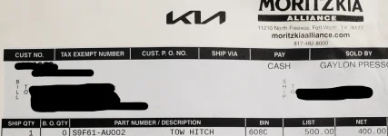

Just to confirm the part the part you have is S9F61-AU002?
Below is the part number I ordered but that was a year ago. I would check with the dealer or on-line provider to make sure it has not been superseded. Since nothing electrical is provided, I would expect that it fits the MY 24 also.
