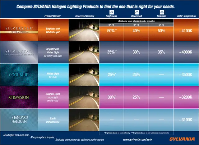

I took out the Sylvania 9005 Standard bulb and replaced it wit the Sylvania 9005 super star ultra. Here is s chart. It take 5 minutes per headlight to change and there is a big difference
It is a pretty good difference as I have used those in other cars I have had.. The life expectancy on those are pretty bad though, they burn out fast especially if you do a lot of night driving.
