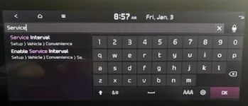

Steps that I followed:
  1. Pressed start button twice without foot on brake
  2. Pressed setup button under navigation screen
  3. Touched the Vehicle icon
  4. Touched the magnifying glass icon on the navigation screen with brought up a search window
  5. Typed in "Service" on the screen
  6. That brought up two results on the left hand side of the screen, one of which was Service Interval and the other was Enable Service Interval

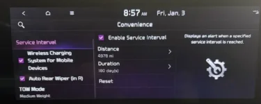

  7. I changed my Service Interval to 5000 miles and then reset it as I had just recently changed my oil and filter
I don't know if that is available without first asking the dealer to turn it on. I had read that that was needed and asked them to do so when I brought it in for a recall service.
