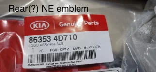

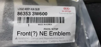

Ok, so there are a few NF parts on eBay which list their corresponding part numbers. When searching one of them, the SX emblem for example, on KiaParts.com it shows a result but has no picture. It is also close in numbering to the non-NF SX emblem (S9030 vs S9060).
So, with that same logic I found the non-NF Kia badge part, did some trial and error on searching part numbers and came across “Logo Assembly Kia Sub” part #86353-3W600, which has no image (like the other NF part), but is similar in number to the non-NF Kia badge (86353-3W500) which also happens to go by the alternate name of “Logo Assembly Kia Sub”.
Could 86353-3W600 be the elusive Kia NF badge?
My logic could be all wrong here, but figured I’d take a stab at it. Thoughts?
Ok, there’s a dealer on Facebook who did the Nightfall badge swap and posted parts. He confirmed one of the part numbers I had guessed earlier and listed the other as well. Not exactly sure which is front and which is rear (taking a guess in my screenshots).
Anybody interested in trying?
Edit: just realized I’m flipping between NE and NF to abbreviate Nightfall Edition. Sorry for the confusion! 😅
Here’s the definitive info
