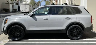

I wouldn’t call it a rub it’s more of a graze with the Ridge Grappler that is generally a bigger tire. If I went Terra Grappler I might not be “grazing” as much.
We took a heat gun and warmed up the fender plastic in the fronts toward the rear where it rubs and pushed it in so it’s out of the way more. There is very minimal “graze” but the tire will wear it out. I don’t hear it at all while I drive.
I have the Toyo AT 3 265/65/17 XD monster rims and I’m getting just a slight rub or graze like Alonzo mentioned. When I’m full turn it’s very mineable but I think I might try the heat gun on the fender. Good idea Alonzo 👍🏻
