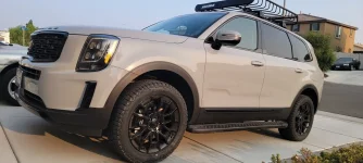

Finally had Nitto RIDGE GRAPPLER 265/50R20 on 2022 SXP nightfall wheels without a lift.
I was not sure if they would rub or not, fortunately they don't at all even on full lock.

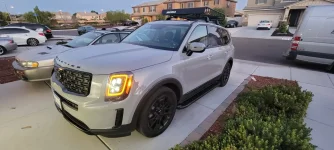

Finally got new shoes on, went with Toyo Open Country AT3, 255/55r20. They did have a slight rub on rear of inner fender well during turning. Easy fix with a heat gun and pry bar. For those that do that, be super careful, thought I was going to put a hole in the well even on low heat

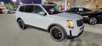

Just wanted to update. Brought car to dealership after tires and lift kit installed and they fixed my alignment problem. 265/50/20 tires work great.
