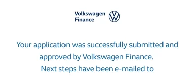

Well, I'm a little sad because Telly was my first choice to replace my Q7, but after 2 days the reading of this thread (all 52 pages) pushed me to my 2nd choice , VW Atlas Cross Sport (love them big, don't need 7-8 places). That and the fact that I can't predict how this car will behave with the time, in 3-4-5 years. I hope you all enjoy your trucks and be care free, and those in trouble to find the needed help as soon as possible.
I called today a VW dealership to dip a toe in the water and after 1 hour on the phone and couple e-mails I got credit approved by VW finance instant, (online application ), got 1% interest shaved off, winter tires aded for no cost + the 4 all seasons, first 3 months of the lease payed by VW and about 3000 off the MSRP. Tomorrow at 11h00 I'll go sign the papers and pick up the Cross Sport. The best buying experience ever, and even if I love the VW's square brick look, (the interior depresses me ...)I still have a pinch of regret because I didn't get my black on black Night Sky (our Canadian version of Nightfall) Wish you all the best, enjoy your rides!

You let one thread make a major car buying decision. Good luck; have you checked out the VW forums?
If you got a good deal on an Atlas best of luck to you. But one issue on some models of a few trims that “might” happen which appears to have a published fx in the Palisade does not define the Telluride. If you are serious about research you should check into recent VWs and their track record. You may be trading one possible problem with AWD that has a resolution down the road for a larger possibility of engine, transmission and electrical down the road with expensive VW repair costs. VW also lowered the warranty coverage of the Atlas recently, they must assume everyone forgot about dieselgate. In Canada you now get 4yr / 80,000km (50,000mi). You might want to add in the extra warranty you might need it.
Did you join any VW Atlas forums? As with here, there are all kinds of problems posted with that vehicle. For example: Volkswagen Atlas Complaints, Issues And Problems
I'm not bashing Volkswagen. I bought my son a GTI and he loves it, and no problems at all (so far!). It's a great car and we're hoping it stays problem-free, but like anything, it's a bit of a gamble. All car manufacturers have problems. Very few owners here have a vibration issue or any other issue. But it's a car forum where people come to share their joys and sorrows.
I hope you love your Atlas - like we love the GTI. It's important to get what you want. Best of luck!
