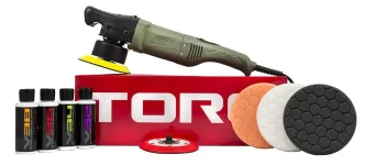

Can you share the tools and polish you used?
Amazing results on your first go at polishing!!
TORQ 10FX Polisher from Chemical Guys (Dual Action - worked great)
4" pads
STEPS:
1st - Clay Block and Luber to clean surface
2nd - V36 compound with green pad to cut (remove scratches and swirls)
3rd - V38 polish with white pad
