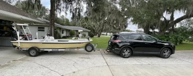

I doubled checked with the U-Haul guys and they tell me I should be OK towing my fishing boat without trailer lights. The state of Florida does not require brake/turn lights on a towed trailer if the drivers behind can see your tow vehicle brake/turn lights. As you can see in the attached photo, my boat is a really low profile flats polling skiff and I have not been stopped for bad brake lights while towing it for 15 years…and my brake lights do not work half of the time.
