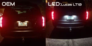

Ya super easy but seemingly soft screw heads so avoid a power tool, use a hand screwdriver or just go real slow/careful with a power drill with a screw bit in. The heads got worn down a bit using the power tool so switched to hand power.! Much whiter and brighter with LED
If you don't mind me asking, how do you get the clear plastic piece that contains the bulb out after un screwing it?
I actually used the screw itself and stuck it partially back into the hole and used it to get a little leverage to pop it out. Try putting the screw in like a quarter of the way and push it side to side as you pull downward a little to help get a "grip" on the housing to pop it out.
