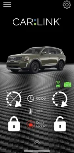

The SX trim is finally a selectable option on the Carlink App. 😁 They were missing it for the longest time.

  1. 15 minutes, not adjustable
  2. Not that I am aware of. The app can also be controlled by Alexa/Google and your smartwatch. https://www.carlinkusa.com/ASCL6/
