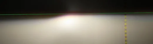

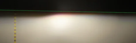

The numerical aim information for the Telluride is actually missing for some reason (see below). But there are still pictures. The IIHS documents all of its testing very well.
We can see that the left headlamp is aimed slightly low. The right portion of the cutoff should be resting on the green line. This one is just a tad low.
We can see that the right headlamp is aimed way too low. Again, the right portion of the cutoff should be resting on the green line. But this is the state that the headlamps are tested in.
You can clearly see two things here:
  • The two headlamps, left and right, on the Telluride tested by the IIHS were not aimed the same
  • The two headlamps, left and right, on the Telluride tested by the IIHS were both aimed slightly low
In a perfect world:
  • The two headlamps, left and right, would be aimed the same
  • The two headlamps, left and right, would be aimed correctly (cutoff resting exactly on the green laser line)
Instead, we pay $$$ for our cars and get basically random aim from the factory. There is not even consistency across the left and right headlamps on a single vehicle!
