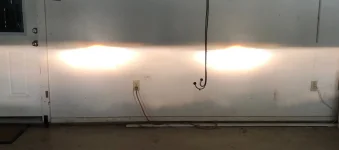

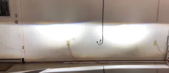

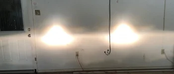

Just replaced the stock halogen on the EX to the Twelvevolt 9005/9006 LEDs.
I took off the large O rings on the new LEDs and installed the smaller ones. To better reach the passenger side bulb, I used a 10mm socket with a 3" extender to remove a bolt holding down the windshield washer reservoir. Then I just moved the reservoir over a little. Made it a lot easier.
Low beam-Before/After
High beam-Before/After

I don’t get it. In the pictures above your post, the halogen lights look brighter and focused exactly on the center of that concrete driveway—as they should be driving down the road. As for the LEDs, they definitely look whiter, but not as bright as the halogens or focused at all. It just looks like a wash of white light to me. Don’t see how it makes driving any safer.
