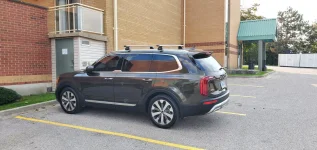

Thule Cross Bar Installed
Finally got the fit kit KT 4113 from Thule. Perfect fit...
Here are some pictures of the fit kit and cross bar.

At the current mounting location, the wind noise from the WingBar is really minimal. I don't even notice it.
I chose the WingBar instead of the Aeroblade primarily because I like the style better. Secondarily, it provides a wider load carrying surface to carry more gear.

@jazzyone Is that Thule 4113 system using claws to clamp the rail, as opposed to permanent hard points?
Is there anything preventing you from installing the bars farther apart (fore and aft)? For me, the Thule Canada site says 27.5" is the maximum bar-spread but I'm not sure why.
Anyways, thanks for the awesome photos and detailed information. Looks great!

I had the same question before I purchased the Thule crossbars because I am carrying kayaks. Here is the answer: Thule Cross Bar Installed
Here is the link to the Thule Canada website that mentions the maximum barspread of 27.5" (click on "Read before purchase"): Thule Evo WingBar
@tazzytazzy @Jasman In my case I am carrying lightweight composite kayaks so the total load on the bars is relatively small. As mentioned above, this Thule system uses a clamp style mount so it can technically be mounted anywhere along the rail. To be safe, I would contact the manufacturer for more details on your specific application.

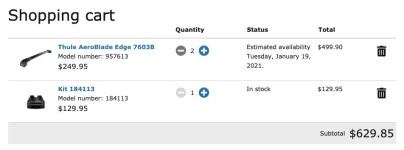

Sorry. Im really late to the party but I'm close to choosing a rack system. Have we established that the Thule systems leave enough room for the sunroof to open? Here's what I'm leaning towards: The Thule AeroBlade Edge 7603B. From what I can gather, the 4113 Kit should fit the Telluride rails, correct?
Again, sorry if this has already been covered. Just trying to make sure everything fits before ordering.

If you read the thread from the beginning, you'll be able to find the info you need.

I didn't get the AeroBlade Edge, I got the WingBar, so I can't answer your question about the sunroof.
But are they the same kits, the 4113?
You probably already know that the "Kit" is the Rubber part (and maybe the hook) that mates the foot to the rail. The Fit Kit is car specific. The other parts are generic/universal (with the exception of the bar's length itself). That being said, go with what the Thule website says is required for the KT for your specific configuration.
