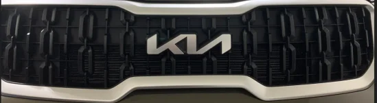

I finally got my Kia Telluride (2023) and I think I'm finally going to purchase the guards. Do you have any pictures of a 23 with the guards on? All 4 piece?

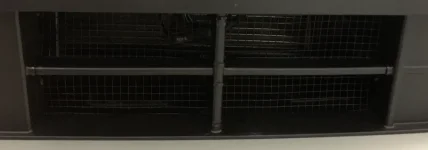

Here are a few, Freakrule. Not sure I have one of all 4, but this assortment should give you the picture. Note that the upper piece is installed behind the grill, so you won't really see it unless you zoom in pretty good on a couple of shots. (Not every one has the upper piece in it.) The lower pieces are shown in front of the grill in some and behind in others, so you can compare them for what is best for you. Note that all of the pieces can be installed from in front of the grill in the 2023. You don't need to take anything apart. You can if you want to, but it is not necessary. And yes, I do think it is worth it to put them behind the grill if you can.

The upper one behind the grill can also be installed without removing anything?
Yes. The slots in the grill are large enough to let you slip the piece in from the front and maneuver it up into place. You will want to hold the screen up to the front of the grill and locate where you want the plastic ties to go to hold it to the grill, then thread the through the mesh in advance. Once you insert the screen through the grill, you work it into position from the front, then fasten the plastic ties.
Here are a few demo pics to juice your thinking.

The 4 piece sets are $160-$180. That includes shipping within the Continental US. There are 3 different mesh choices, Black expanded metal mesh ($160) , black welded stainless steel mesh ($180), and black woven stainless steel mesh ($180.) These are pictured below in the same order. As noted earlier, The lower 3 pieces can be installed in front of or behind the grill. The upper piece is designed to be installed behind the grill. All of the pieces can be installed behind the grill from the front of the car without taking anything apart. Installation of the 3 lower pieces in front of the grill is very easy. Installation behind the grill takes a little fiddling with your fingers to position the pieces, but it is a nice stealthy look.

The grill guards work great! Thank you again. I feel better knowing something is blocking those big holes! Lol. I have pictures but the site says they're too big. If I ever figure that out, I will post pictures.
i had a 2020 with a rock into the condesor for about 1600 canadian i put a mesh on the inside over the grill openings after that
